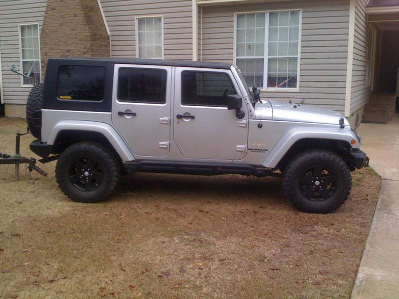

Okay well I've got the 2.5 but it doesnt seem big... At all I just don't feel like 4 inches will be " huge" either. I'm 6'3 and only 20 so getting in and out of the jeep isn't a problemo. My jeep just seems small and I don't like that:(
Old Feb 22, 2011 | 09:20 PM
captjay's Avatar
Posts: 632
From: pensacola, florida
it doesn't seem big, because 2.5" is not big. Unless you are trying to fit 38-40" tires, there is no need to go 6.5" of lift. I have 4.5" and 37's. If you are going to offroad your jeep, you should keep the low center of gravity and only do the 4" lift and maybe later, if you stil don't like that, then do a 1" body lift.
It is not about being "huge" (atleast not offroading). The higher you lift the JK, the higher risk you have to roll over on the trail and on the road. Higher you lift, there are also more and more things you need to modify, which means more money out of your pocket
Not trying to rip on you, but since you are only 20, I think you are young and may be looking for some "cool" factor having a "huge" Jeep, which there is nothing wrong with that. But you should be smart about what you want to do. Take your time, read, and listen to these people's opinions. Now if you looking to just drive in on the road and be a Mall Crawler, then you do what you want and go as high as you want and as far as your money will take you.
As another 21 year old, i agree with this man. Thankfully i am a cheap schmuck and don't rush into most things.
You should do what i did, i just purchased a Rock Krawler 2.5" Suspension lift with bilsteins and RC discos for $830 shipped. Should net me about 3" and i can fit 35s.
Go to a suspension lift from the BB.
