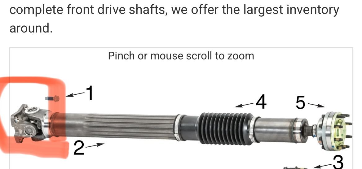

2012,SAHARA
The part is as shown in the photo.

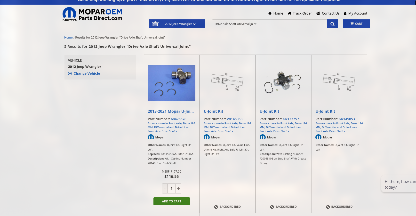

Part number: 68476678AA
Mopar part or Quadratec and the likes have them with varying prices.
The name shows 2013, but I searched on a 2012 Sahara (my wife has one) and the site says it fits.

Drive shaft and axle shafts are 2 different things. Drive shaft goes from transmission to differential on the axle. Axle shaft go from differential to wheel inside the axle.
Your pick showed a drive shaft. Were you looking for the axle shafts?
