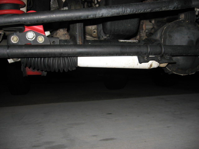

put it above bar if you bracket, if you dont you can do this temp. til you get the bracket....i would do this as a tempary solution, but works, and doesn't bind at turns.
