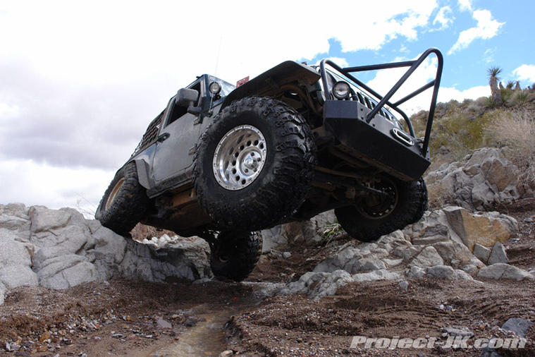

Yes, I've run 37's on my JKU for 3 years now and currently have 38's on it.
