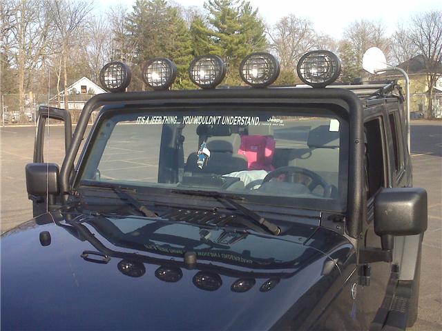

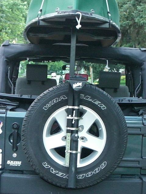

I have a windshield light bar from rugged ridge. Very sturdy
ID:	61235   Click image for larger version

Thanks. That is the one that I like best so far. Just cannot take it off.
