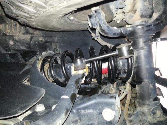

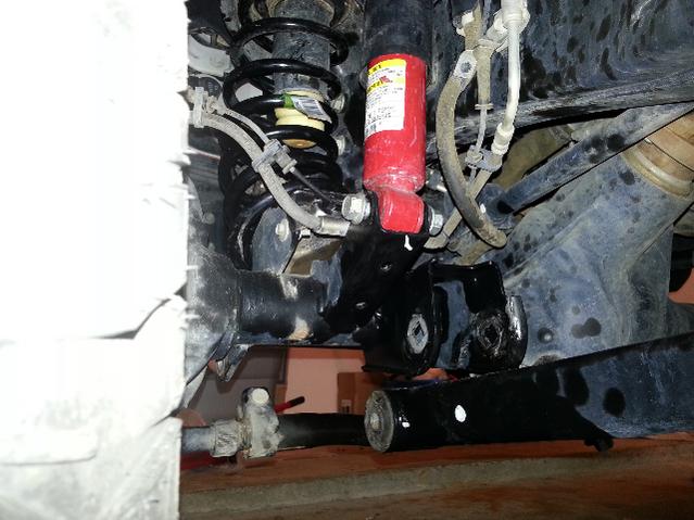

Old Dec 9, 2012 | 09:39 AM
Ezekiel97's Avatar
Posts: 472
From: At the mall, AL
Old Dec 9, 2012 | 09:44 AM
09SDunlimited's Avatar
Joined: Mar 2009
Posts: 228
From: Clovis, NM
Originally Posted by Ezekiel97
I wouldn't reverse the jeep to allign the control arms. I would take the wheels off. Jack the frame up. Place jack stands under the frame. Use the jack and rachet straps to lift and twist the axel to allign the control arms.
On a side note... I thought all JKs had the same length control arms on the front from the factory?
Old Dec 9, 2012 | 09:47 AM
Ncb's Avatar
Ncb
Posts: 1,087
From: Parker, Colorado
Have a helper roll the front tire to align the control arm with the bracket. A wheel chock will take pressure off once it's close.
Old Dec 9, 2012 | 09:48 AM
jadmt's Avatar
Posts: 4,364
Likes: 107
From: missoula,mt
just give it a hardy kick and it should/will line up. the above posts are both right on too.

Old Dec 9, 2012 | 09:54 AM
Zpack's Avatar
Posts: 262
From: Ohio
thanks guys. I'm going to see what reverse will do...then jack up the frame and see if i can't then jack the front axle enough to get the sway bar end links connected then the control arms. A little freaked out on how much of an angle my drive shaft is at the transfer case
Don't reverse it, just have a friend push on the tire.
Old Dec 9, 2012 | 09:55 AM
Ezekiel97's Avatar
Posts: 472
A little late on not reversing it..I rolled in neutral and now the control arm is behind the bracket. I'll do what you said just in reverse.
