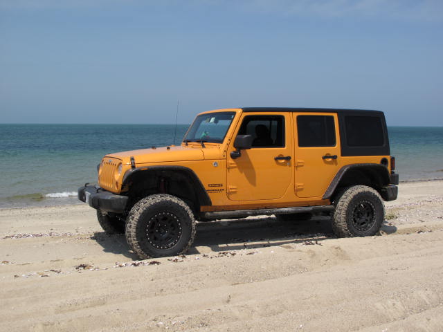

Old Jun 10, 2013 | 04:57 PM
muddr1's Avatar
Joined: Apr 2013
Posts: 11
From: Weare, Nh
Here is the end result
