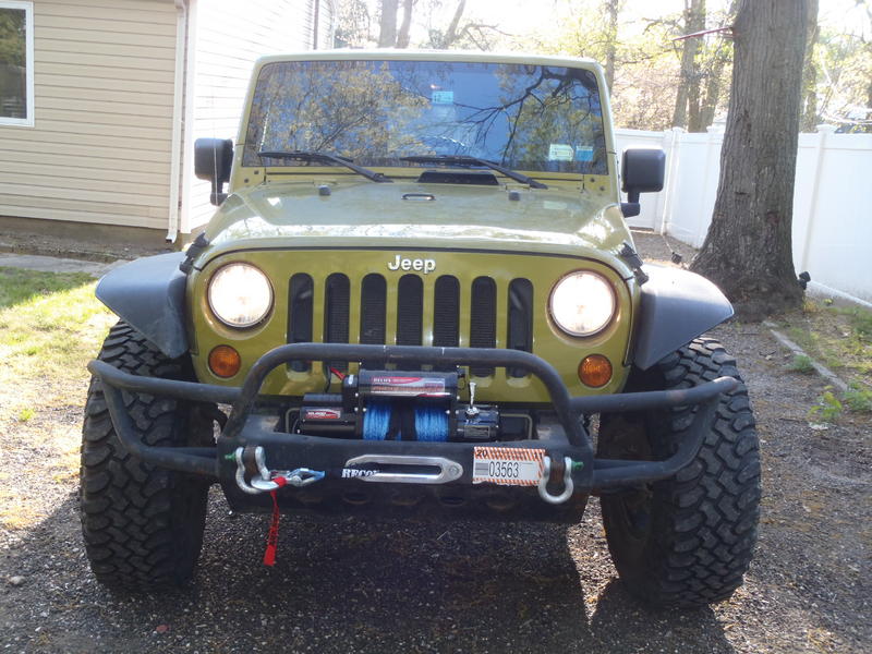

Can you post a few pictures of the front of your Jeep? I think that might help in the design process.

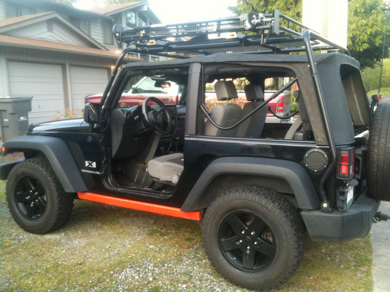

Get a roof rack

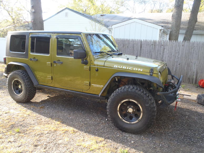

I am looking into roof racks they are just to expensive for now. Here is my front as it is now.
ID:	310755   Click image for larger version
