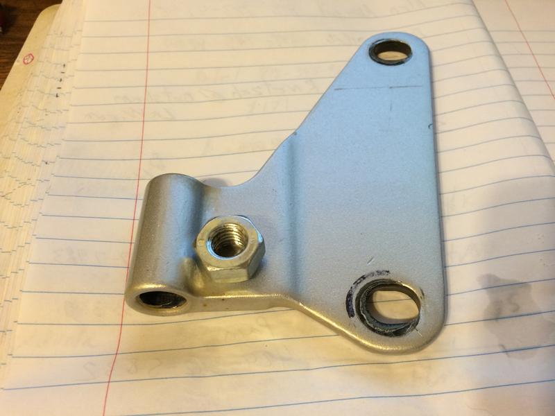

I want to weld a nut on the door hinge but I'm afraid it may be cast iron.
Anybody knows for sure if the door hinges are cast or forged?
Please reply only if you know for sure.

seems like a bad place to use cast but very well could be. You could always do the grinder spark test.

Glad you asked and posted a pic. Good question.
My 2 bets would be: multi-stage process-stamped 2 part tack welded assembly of thin plate metal.
: cast steel
Before I'd use a grinder and cause damage you'd be better off to start with a good strong magnet test. And noa fridge magnet advertisement doesn't count. Use one on the end of a small screwdriver head (not bit holding tip). Good attraction contact is what you're looking for to do a fairly normal type of weld on a home model weld m/c.
No attraction and you may be getting in over your head to do the weld yourself. eg aluminum but that's the material on the door side of the hinge. Cast iron .....NOT...just look at the suface texture. neither would attract a good magnet.
Just by asking the question in the first place I'd say you might want to take it to Joe's weld shop down the road to get advice. The part's already off and if you get there around lunch time they'll be glad to help. And for you showing up not sounding like you know it all they might even weld it up for free.

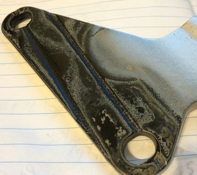

It doesn't look stamped or 2 part tack welded assembly.

There are these grooves on the back of it that suggest casting.
