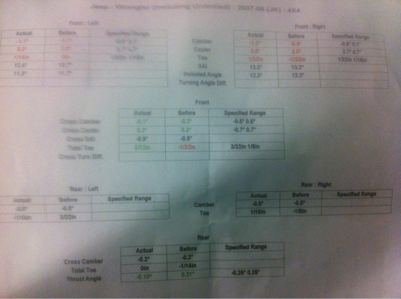

A snapshot of the numbers post alignment

Picked up after the front end was aligned, no change.
I have the 9/16" bolt in the upper mount of the trackbar, torqued to 150lbs. The lower mount is the factory hardware, starting to wonder if this should be upgraded to a 9/16th bolt as well.
The bolts I have are shouldered grade 8 fine thread. Using a grade 8 nylock nut.
I also have washers (not welded) on both sides. Is this correct or a concern for slipping?
