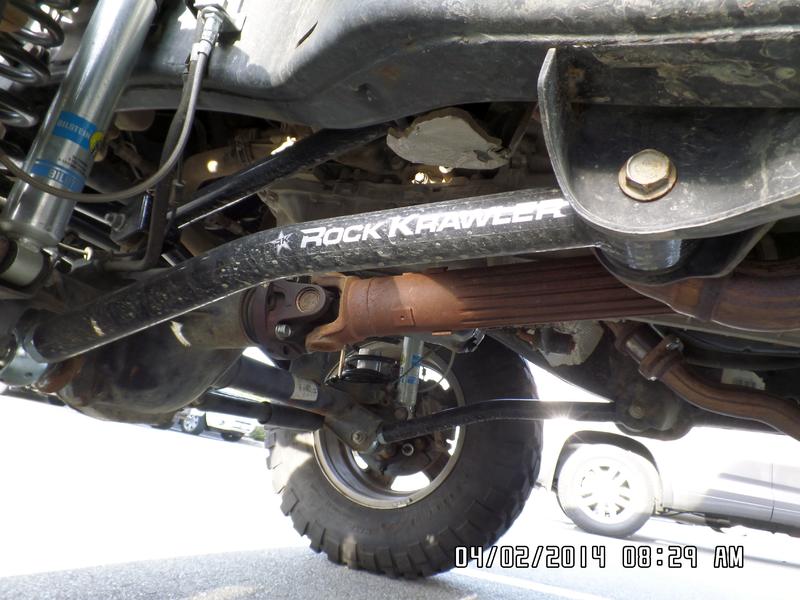

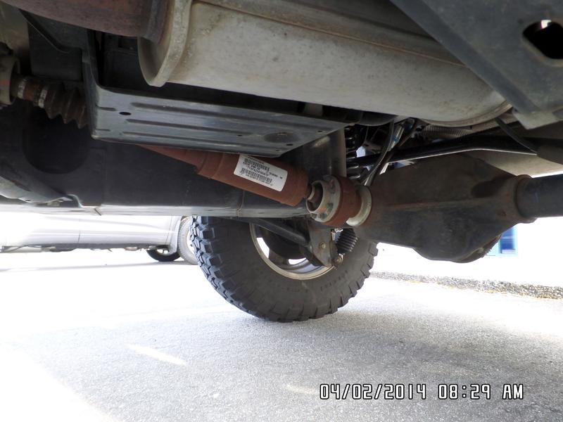

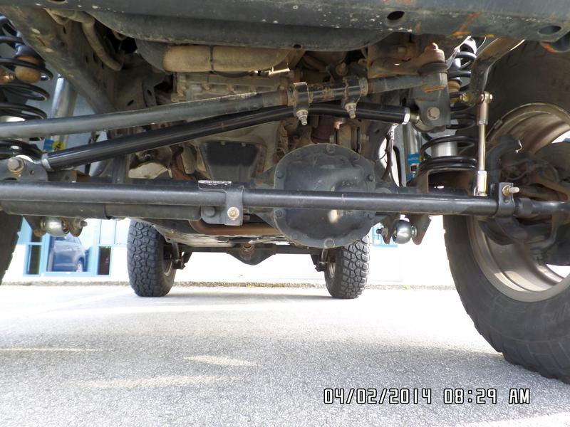

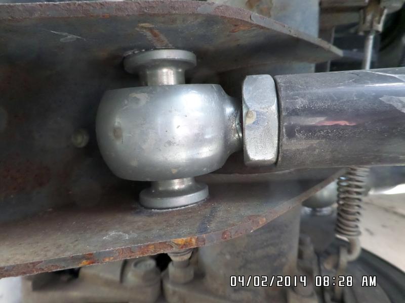

I have attached some pics for you Bunny. Just FYI - You need to replace the LCR front and rear when upgrading to X-Factor from Flex. The LCA are longer in comparison to push the axle back 1" of stock. Note the 2 different sku's on the rock krawler site when you go to purchase the arms separately.
I also added some pics for fun so you guys can see the whole setup basically. If theres something i should know about please let me know!

If you could take a picture of your knuckle, that would be great. Hard to see your caster from that picture. If he put you caster at .08 degree's, that definately needs to be changed.

So the short answer is don't let that shop touch your jeep anymore. In a perfect world, people run 4-6 degrees of caster. You've still got your stock drive shafts that can tolerate a more substantial difference in pinion angle and drive shaft angle so there's no reason for you not to be running in that range.
If/When the day comes that you upgrade to aftermarket drive shafts, you'll have to do a little compromising as the aftermarket shafts need to have the pinion angle as close to the drive shaft angle as possible. With a lift, that means the pinion needs to be set steeper as you go higher and higher. Since a JK only has 6 degrees separating caster and pinion angle, this usually has you running in the neighborhood of 2-4 degrees caster. It's a bit of a compromise but it sure as hell isn't Zero. At zero the jeep is going to be super flightly.
Id suggest you get a magnetic angle finder and a couple of come-alongs and fix it yourself. You can measure off of the drive shaft flang and subtact 6 degrees and that will ROUGHLY represent your caster. IE pinion at 0 caster at 6, pinion 1 up - caster 5, 2up-4 and so on. It looks in the pics like they bottomed out your lowers and the axle needs to rotate longer in that direction anyway, so THIS TIME ONLY I'd set caster with your lowers which will have the double benefit of centering your tires better in the wheel wells at the same time. It'll only involve removing two bolts and its super easy to use the come alongs to rotate the axle forward/back as needed.

If I look at the last pictures on the right we can see the pinion angle from the front axle and I believe my JK as a steeper pignon angle than this. My caster is at 4.3
So I think the caster need to be properly set within reasonable range between 4 and 5 deg.
