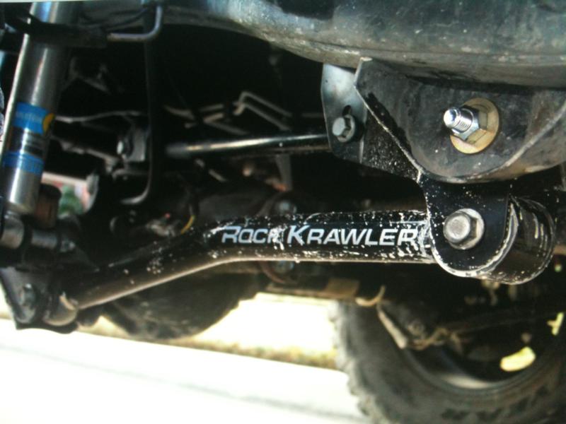

Stay away from cam bolts. I did AEV with drop brackets but it does lower clearance by a few inches only on front lower control arm, but not an issue unless you are rock crawling. I elected them and added aftermarket Lower arms for adjustability. It rides great!
