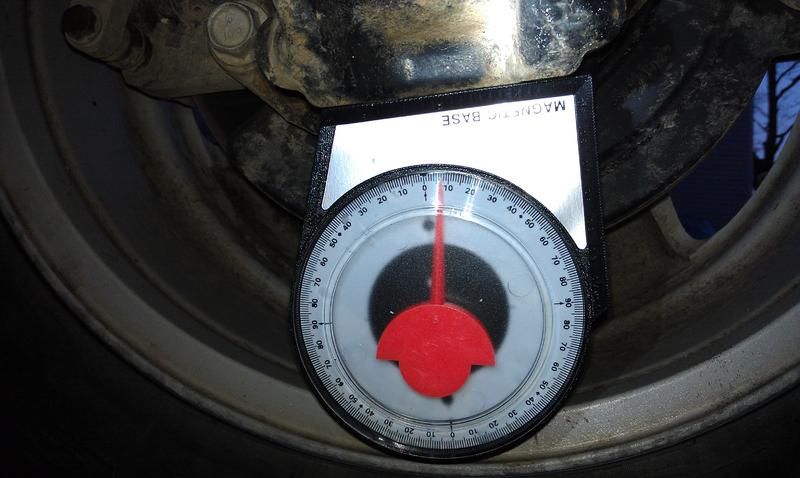

i personally like taking a reading from the top of the ball joint as it's quick and easy but, if you pull off your drive shaft from the pinion and place an angle finder flat across it top to bottom, that being at about zero should be right.
well pulling off the driveshaft sounds as fun as pulling teeth. When you say you do it from the top of the ball joint, what do you mean? I reference your writeup, where you have a picture of the angle finder on the 2 notches on the bottom of the C, so thats where I was measuring the caster from. Are you recommending measuring from a different spot?
Attachment 294769
yeah, put your angle finder on top of your ball joint and take a reading there.
