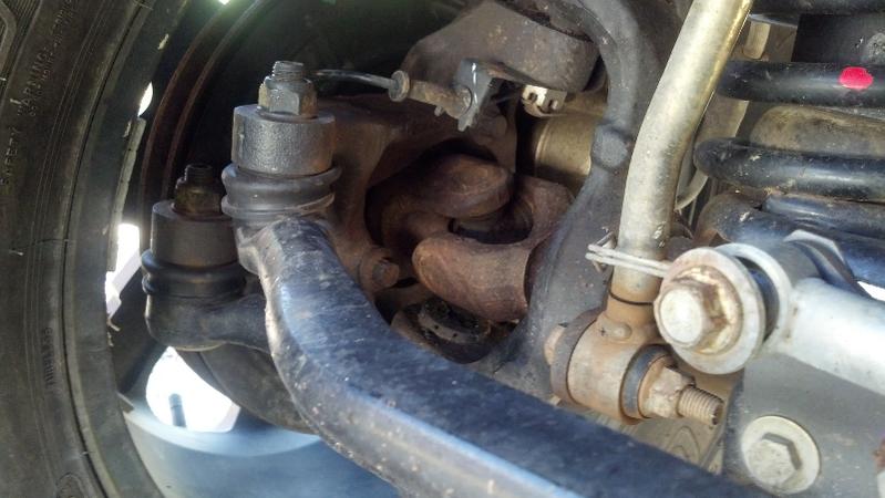

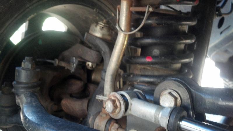

I just got under it and took these.

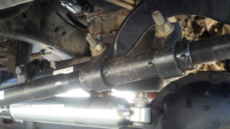

Old Sep 22, 2012 | 12:17 PM
  #25
Nkrimmel2012's Avatar
Posts: 659
From: Tallassee, Alabama
Its definitely not a flip kit.. how hard are those to put on... so am I looking at about $1k for flip kit and front DS.. also I saw somewhere I have to have a stock pit an arm to have a flip kit.. and people say the skyjacker lift comes with a pitman arm.
