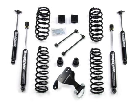

I recently purchased the Teraflex 2.5" coil lift with Bilstein shocks. As many of you know, the recommended rear Bilstein shocks (part #24-146715) to be used with this size lift have been on back order. As an alternative, vendors are selling this combination with slightly longer Bilsteins (part #33-186887). The advantage of this is better articulation.
What may not be obvious, however, is that these longer rear shocks will cause the upper portion of the rear springs to dislodge while under full articulation. This issue been discussed in a general sense in other threads on JK-Forum (e.g. here).
Among other solutions, the above thread discusses coil guides/spacers that were included with certain TF 2.5" coil lifts:
However, TF is no longer including these guides (for any 2.5" kits with or without shocks):
I have been told that TF is working on updating the pictures on their web site to accurately depict the parts that are included with their 2.5" lifts.
I started this thread to give everyone a heads-up about this. If you are running the TF 2.5" lift with aftermarket shocks, you may be in a situation where the upper portion of your rear coils may become dislodged under full articulation. This in result may cause safety issues. If this applies to you, be sure to implement a solution, such the TF 1/2" coil spacers (part #1954105), to remedy the problem.
