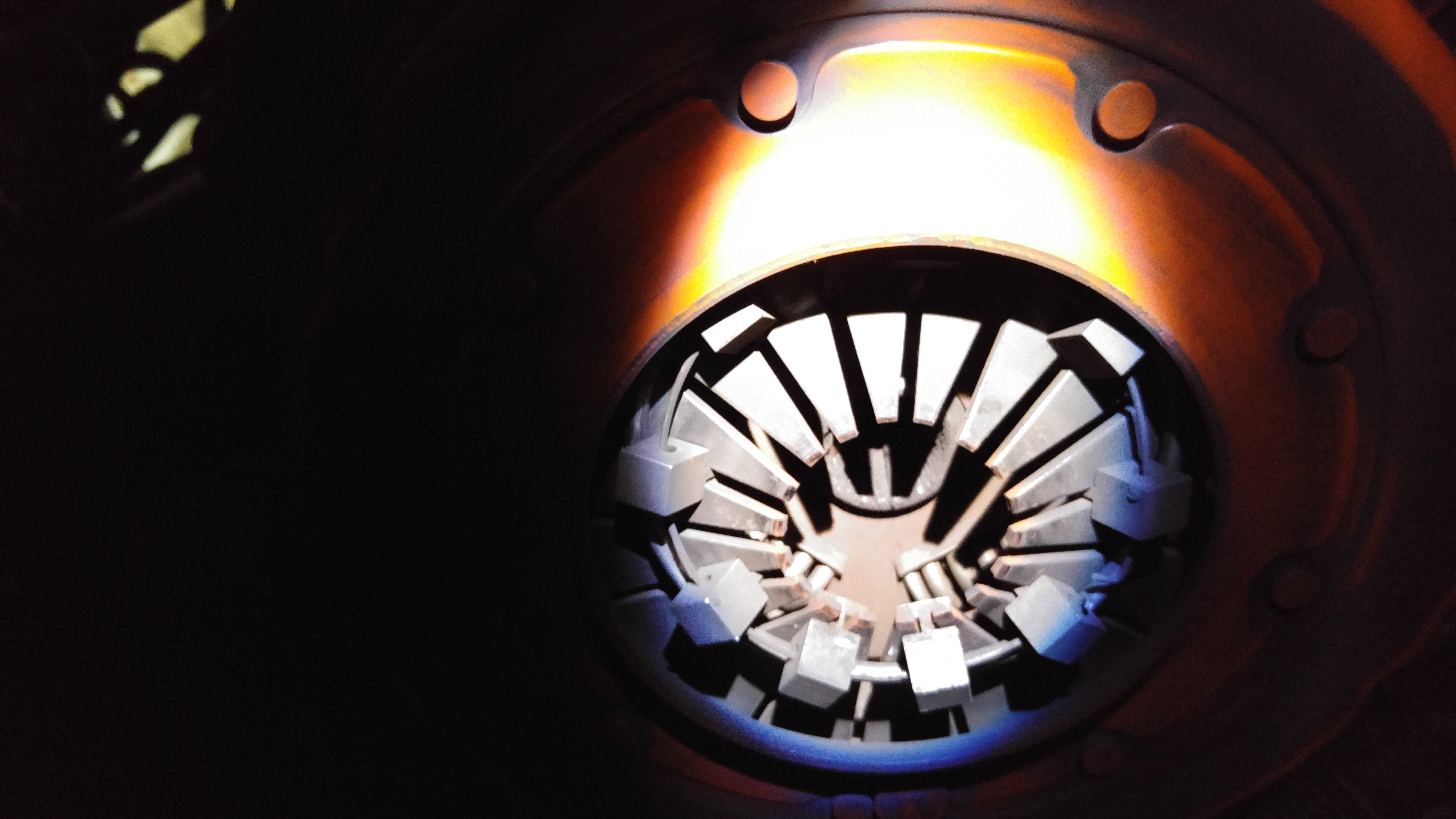

I had the same chatter problem. Since the clutch was installed by mechanic, I immediately thought: "One thing I would not do myself and of course it will go bad."
See the attached picture. The balancing ring was stuck in the clutch housings, as opposed to free floating in the middle. My dilemma now is do it push it back in the middle and risk this happening again or do I get rid of the center balancing ring?

I'm having the same kind of chatter. I thought I had a leaking rear main seal, so I decided to go ahead and have the clutch and TOB done since I was at 120k miles. Turns out that it was the oil pan gasket, so it was all in vain! Anyways, I started getting that small chatter less than 50 miles after leaving the shop. I took it back to them and they said that it was probably the new TOB causing the noise. However...since I had bought the parts beforehand, they wouldn't warranty the labor. If the lightest pressure is applied to the clutch pedal, the noise disappears. The pitch of the noise gets faster if you rev the engine. The new clutch was an OEM, and the TOB was Centerforce. Would you say it is the same issue? The chattering just pisses me off.

Exactly the same as mine. However it's not the TOB. It's the actual clutch, at least that's my understanding of it.
