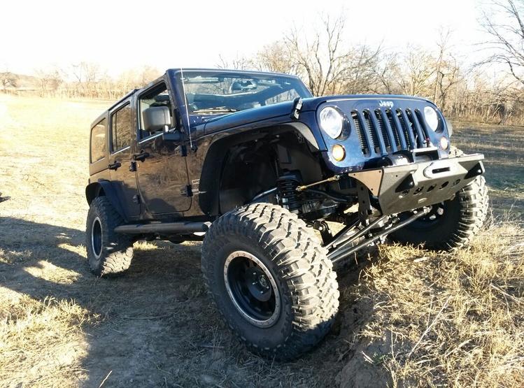

My wife and I have purchased a 13' sport, true blue, and have loved every mile put on it so far. The vehicle is hers....but mine to mod. Lol. I gave her the list and said, "Your gonna love it when its finished." Well, the list is as follows:
Rock Krawler 3.5 mid
17" method double standard
37" Mickey Thompson MTZ
Smitty MOD front bumper
Smitty rear bumper
Smitty tire carrier
Smitty XRC fender flairs
Smitty XRC 10 winch
5.13 gears
AEV ProCal to get it all in check
All on order, and will be ordering:
EVO Sleeves and gussets
To finish it up.
The AEV just came in and gets me a little excited.
Now!
Pictures of the build to come.

We will get out and go wheelin' every chance we get...we work a ton..both my wife and I..but we did just get back from a trip to Hot Springs/Little Rock, Arkansas. My hope was to have everything in and on by the trip so we could head up to the superlift offroad park there, but didnt work out. We did venture off the pavement for a quick photo in the snow.
As for the shafts...i think i need to see exactly what my obstacles are before i keep digging deeper. This is my first jeep, and even though i want to go all out right off the bat, i know i need to keep my sanity. I also have a 69' camaro i am trying to not lose track of right now....my pockets are real deep either...this is a stretch for me by all means.
