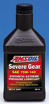

extend breathers...problem solved!
ID:	450762....my choice with Rubi D44 and towing trailer all summer.

I just did mine two weeks ago and chose Outlaw covers with the Jeep logo. I was surprised with only 700 miles on the jeep how much filings accumulated on the magnetic drain plugs. Anyway, my point I wanted to make is that I used Amsoil synthetic and I swear the jeep coasts easier than with what came from the factory. I know it is easy to imagine things if you let yourself but I realized an instant 1 mpg more on the highway so could be a coincidence but I firmly believe in Amsoil and have used there products for many years with great results.
I also used Lubelockers with zero issues. Make sure you use the recommended torque sequence and torque settings.
