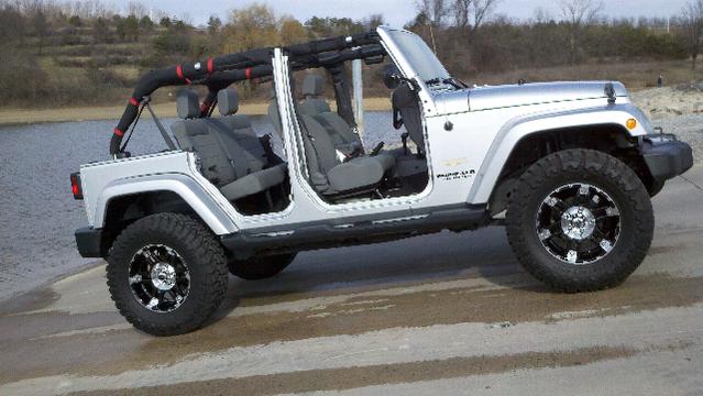

I have a 2008 unlimited automatic and I recently added a set of 35's. I also just ordered a set of 5.13 gears for it. My question is, do I need to also order a bearing kit as well? I have 100k BABIED miles on it and from here on in I will only be putting about 6000 miles per year on..
