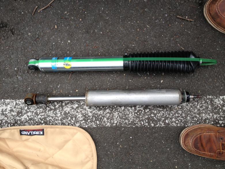

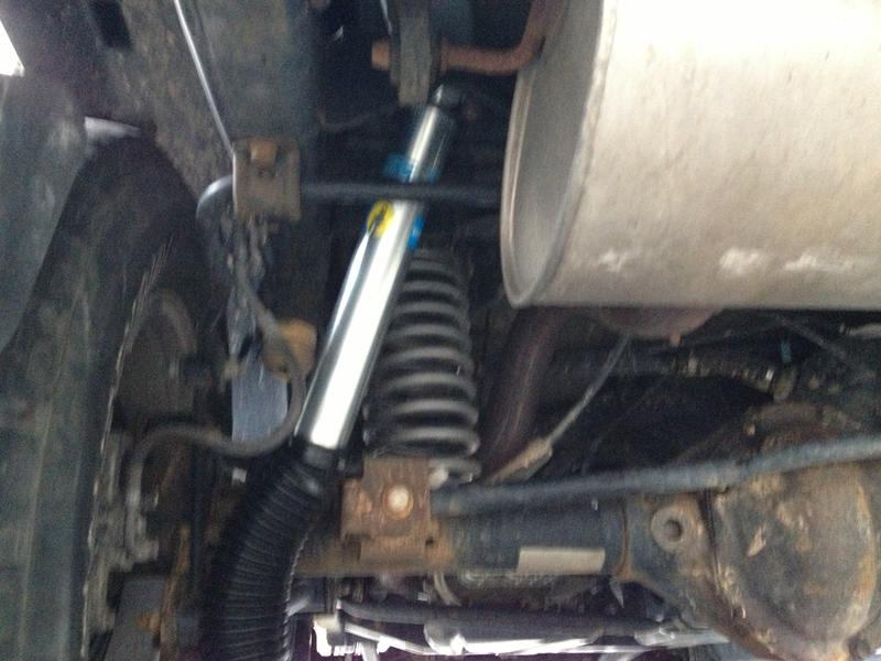

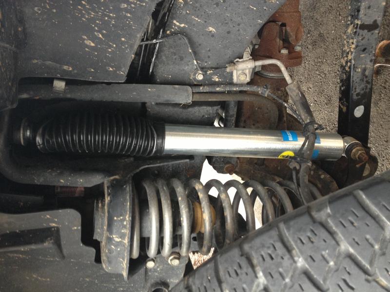

I just changed mine out for Bilstein 5100s. The process is very simple. No jacking up, taking tires off, or using unusual tools. The rears are really easy and the fronts are fairly simple. Just turn the wheel all the way to one side so you can access the shocks easier. PM me if you have any other questions. Here are some pics.
