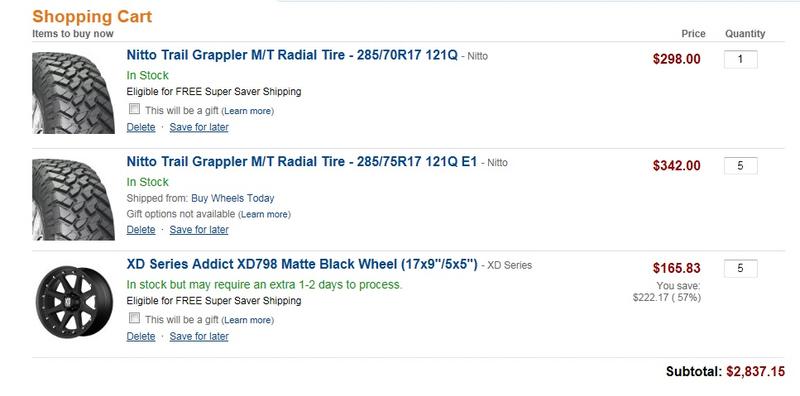

Just checking with you guys to make sure this combo will be okay. Jeep has a 2.5" lift. I still can't decide on which tire though. Is it worth the 75 over the 70 for $40 each? Anyone have a pic with this setup?

I think you will be happier with the 35x12.5 in the long run I got mine installed for 300 per tire
Also a 9" wheel is wide for either of the metric sizes you mentioned

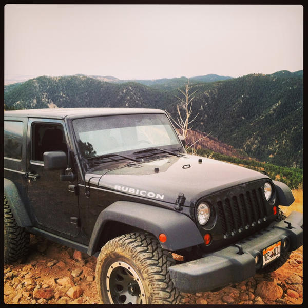

That's a 285-70-17 on a 9" wide wheel with no lift. If I were you I would get the 75s
Hmm.. those are 330 on Amazon.. maybe I'll hit up discount tire. I was going to get it all installed there anyway.
Would the 35 do okay on that wheel?

Yes a 9" wheel would be perfect for the 35

LT285/70R17 E121/118Q 205-930 18.9 33.15 11.81 7.5-(8.5)-9.0 3195/2910@80
LT285/75R17 E121/118Q 205-950 18.9 34.09 11.57 7.5-(8.0)-9.5 3195@80
LT295/70R17 E121/118P 205-710 19.4 33.54 11.97 7.5-(8.5)-10.0 3195@80
LT315/70R17 D121/118Q 205-940 20.0 34.61 13.27 8.0-(9.5)-11.0 3195/2910@50
35x12.50R17LT E121Q 205-730 21.0 34.84 13.19 8.5-(10.0)-11.0 3195@65
Specs from Nitto on suggested wheel sizes

I would go with the bigger size, and yes that wheel is fine for either tire
