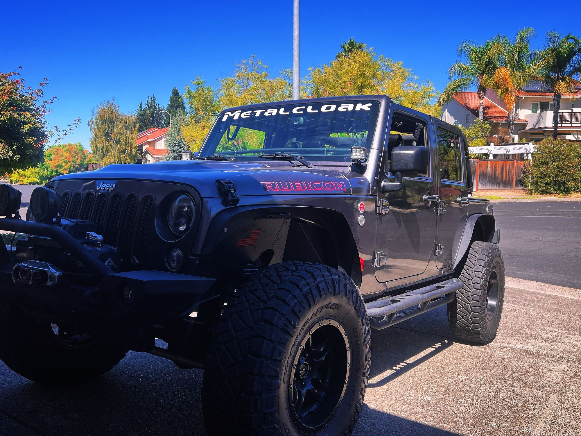

2016 JKUR, 71k miles, 3.5 metalcloak lift, 37’s, stock driveshafts (will be replacing both in next few weeks), no play in ether of them.
Lately (well since taking my top off) I hear a mild clunk when accelerating from a stop and a pronounced clunk when shifting from P to R. There's no vibration or any other adverse affects that I notice. All suspension components are torqued properly. Tranny mounts “seem” ok.
Anybody have this problem or maybe any idea what it could be? Thanks in advance!
