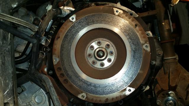

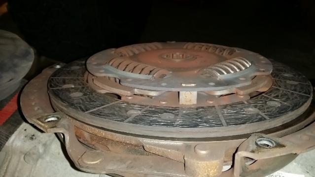

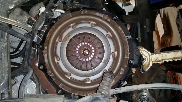

Here are some pics

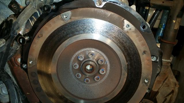

Should I replace the flywheel?

Having replaced a slew of clutches on many different models, always have the flywheel surfaced. (blanchard ground) Being relatively inexpensive, replace the disc and pp while you're in there AND the pilot bearing. I'm personally not a fan of spending the extra $$ on Centerforce for low revving engines but Luk is actually a great clutch and is OEM on many manufacturers.

So a LUK clutch would be a decent purchase for my application? I definitely will not doing any high revving but i would like to crawl some rocks and hit some mud every now and then for fun. I found a shop that will resurface the flywheel for 50 bucks. My budget is around 300. If anyone else would like to chime in with their experience that would be great. I had a hell of a time dropping this transmission and i dont really want to have to do it again anytime soon lol

Can't chime in on which clutch to get cause I haven't looked to hard at them. Will say if your budget is $300 and you can get a new clutch, pp, tob, and pilot bearing plus have your flywheel turned or replaced I would do it all now. The $300 is worth it to me to do it all once. Specially if you had problems/issues dropping tranny this time. Hate to get it all back together and then regret not doing clutch at same time.
