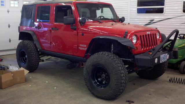

Well i had a tf 2.5" coil lift and didnt think it needed anything at all mine work perfect out of the box. I just put some evo 4" springs on the jeep and i ordered a adjustable front track bar and lower control arms. O and i also had 1" spacers on top of the 2.5" springs and it was just fine. What i would do is install them then decide after driving it for awhile to see what you need! I have been driving on my evo springs for a couple weeks now and it feels a little flighty but not bad. I also have 1" spacers on the evo springs. I will let ya know how much of a difference the control arms and track bar make when i install them next week

Good looking rig Jesse. 37s? Have any issues with your front drive shaft boot with the 4" EVO coils?
