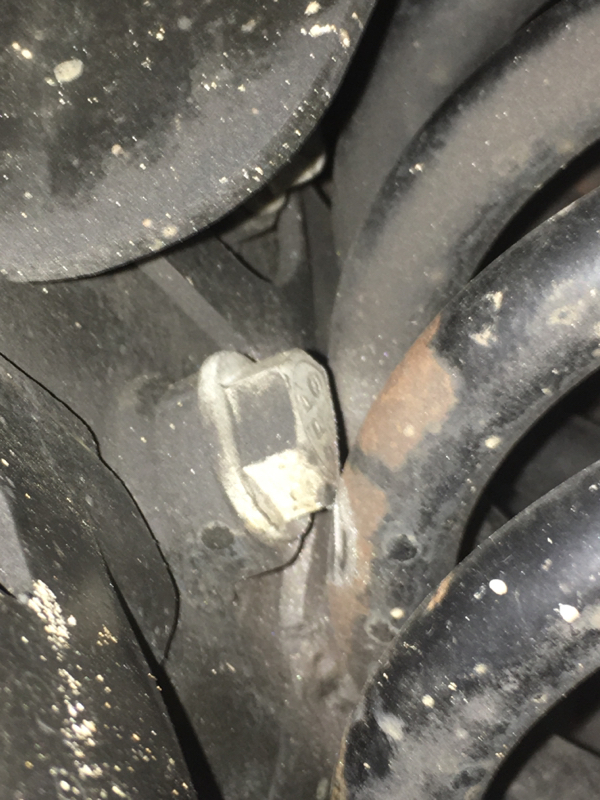

I'm having the same issue. Started squeaking a few weeks back. Mine is even happening during daily driving. My alighnment is spot on so not sure what the issue is. Maybe a sagging coil?
ID:	667900   Click image for larger version

I've had this issue. I had to shorten my front lower arms a tad, just under 23". And I ground down the bolt head some with a grinder.

My front right was rubbing on the sway bar when flexed. I replaced it, and it still does it. Lower control arms is the only fix I can see for it.

might give that a try, I'm like 1/8th longer than stock I believe. But I need it where I'm at for pinion angle.
I have the Jks sector shaft brace so that makes the bolt stick out like a 1/4 inch more I think
