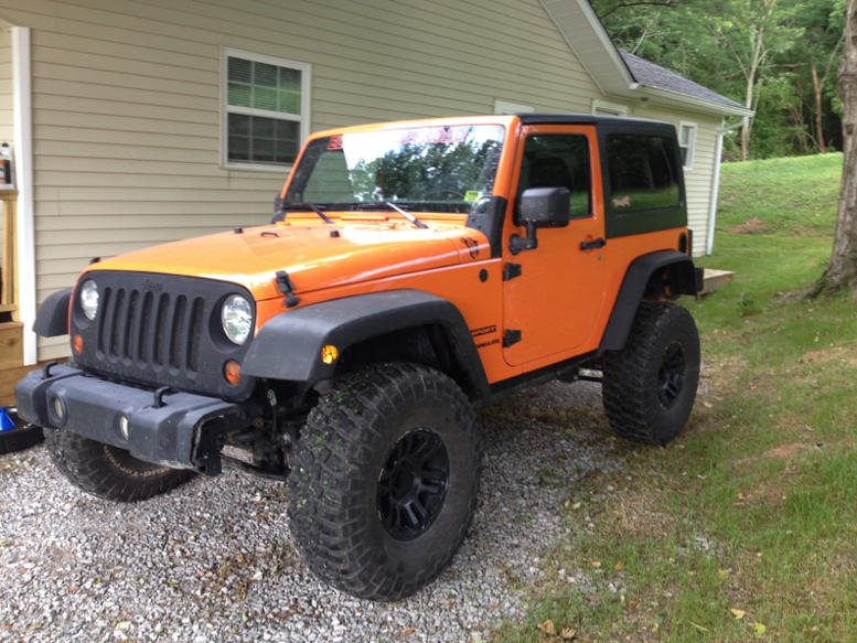

It's not a 6. The guy I bought it from said it was guessing he was saying that because it has a 4 inch lift with 2" spacer in front. I dont know he's an idiot I guess and I just recently figured out what everything is after some research.
Old Jun 5, 2013 | 05:20 AM
kh202's Avatar
Posts: 3,142
From: Rockwood, TN
Attachment 465033

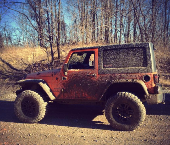

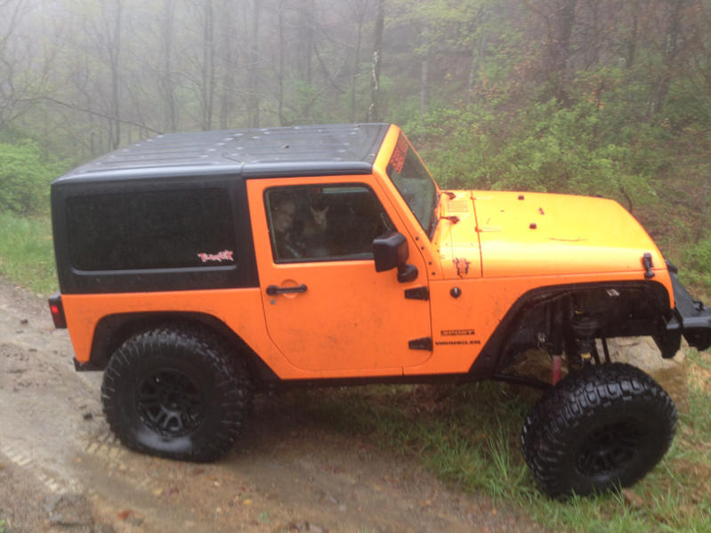

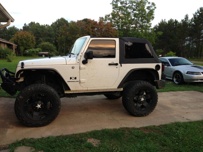

Yeah that’s your call man. I personally like a lower COG for a 2 door. Makes it more stable on off camber stuff. Just keep in mind, some springs like Rock Krawlers are the same for 2 door and 4 door. IE 2.5" RK springs on 4 door will give you 2.5-3", but on a 2 door, more like 3.5-4". I run 2.5" with my 35's and like the way it sits. But everyone is different
