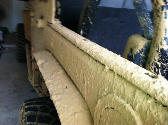

I bought the front EVO coilovers first and rode with regular coils in the rears for a month, it'll work but the rears dont keep up with the coilovers in the front. Your front end would soak up all the bumps but the rears would be all over the trail if you were going fast, especially on curvy trails. I have tested the front and rear coilovers at 45-60 mph on open fields with lots of bumps, ruts, mud holes. The rear coilovers definitely soaked up the bumps but bottomed out a couple times so they would also need air bumps.
