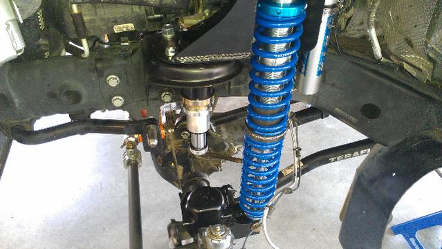

Originally Posted by highwayman
BB, yep. Those are the ones I'm running. In conjunction with airbumps & teraflex arms (8).
Attachment 455869
that looks great. I am pretty close to pulling the trigger on the bolt-on kit.
Is there a significant benefit over my coils and shocks when at higher speeds on rough trails?
As opposed to? Coilovers? I was running fox 2.0 remote resis and aev coils previously. Also ran the foxs with teraflex coils. No comparision between the 2. Coilovers are the way to go on road and off. Especially high speed stuff. If high speed off-road is also in the plan, airbumps frt and rr are the only way to go.
