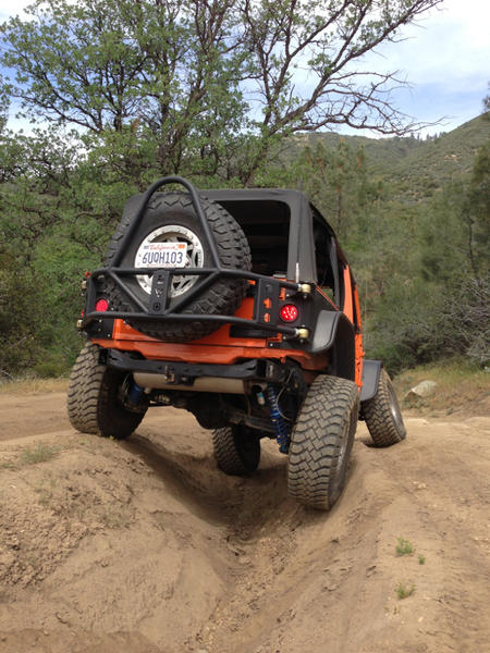

Yes you can run the c/o without a Longarm setup. Not sure if you're referring to their bolt on kit or not but, I've been running evo c/o setup with a teraflex short arm setup for awhile. On the bolt on kit, I can tell you the rear setup with adjusters bottomed out runs a true 4"of lift on my 5800 lb rig. I'm running 37's with airbumps. I have heard they are now offering 10"coils in back for a lower height, but youd have to check. Just fyi.

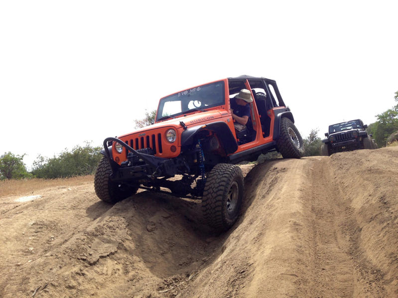

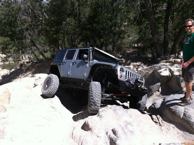

Yes, you sure can. I'm running the Bolt on Coilovers on my personal rig. The factory stuff will take a beating. You will need front lower adjustable control arms at a minimum. You will not lose any travel with short arms either.
