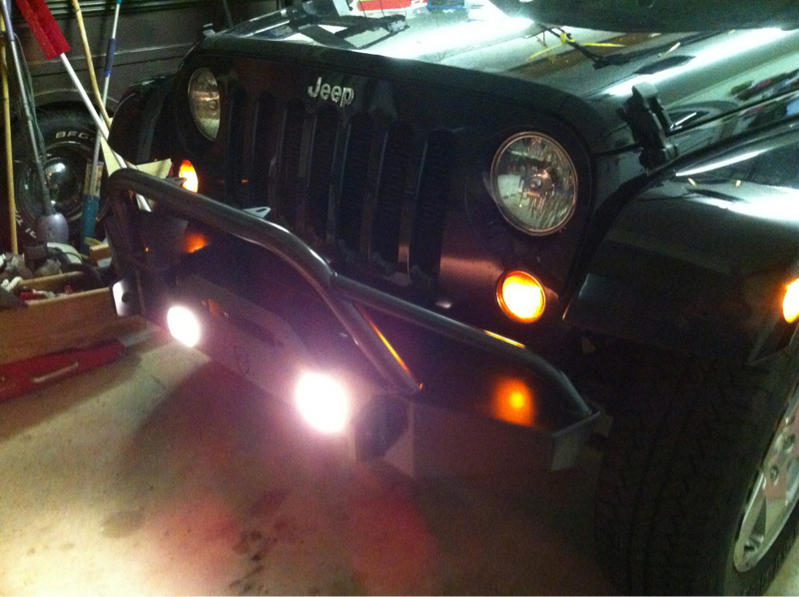

Got the bumpers installed. It didn't seem to drop any until I pushed down on the boer. It failed to spring back and I measured again-it lowered about 1/2". I'm sure it will lower another 1/2"-3/4" when I get the winch installed.
