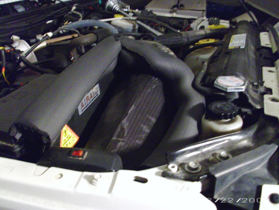

I modified my Airaid, added a piece to the front splash guard , added pipe insulation to the top edge so that it actually seals from the hood where water tends to get thrown by the serpentine belt. Added a pre-filter aswell. I'm careful in mud and water, filter has never gotten more than a few drops of water on the prefilter after hitting a foot and a half of standing water at 30mph(oops)

looks solid.. did you notice any difference covering it up like that? whats the red switch for?

Put it this way, it gets better flow than stock, but not as good as completely open. I also have a flowmaster 40 muffler. I had put the stock box back on after I had driven like this for a year and noticed the diff right away and not just in sound. Red switch, that's a secret, muuuuaaahhhhahaaa.
Not really, it's an led truck bed light with a magnet on it. It fit perfectly there and is handy as an underhood light. I just move it when I need it and stick it whereever
