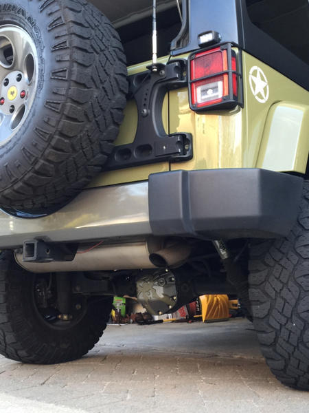

It really does never end. I have Metalcloak's 2.5 in kit and I love it. You can't go wrong with Terraflex though, either. The Metalcloak is just a little more expensive. If you're running stock drive shafts you're probably going to need exhaust spacers. I didn't do that and the rubber boot on the drive shaft above the crossover pipe melted.
Attachment 606788
Yeah, through some conversation I've been having I am leaning on throwing a front drive shaft into the build. I have seen plenty of post of people who have gone thousands of miles on and off road with no issue, But also a lot whose drive shaft didn't last a week. I don't feel like being in that camp. I'm a do it once do it right kind of guy. I know the inevitable tinkering and upgrades will follow, but at least out the gate i want the build to be as complete and solid as possible. Thanks for the input.
