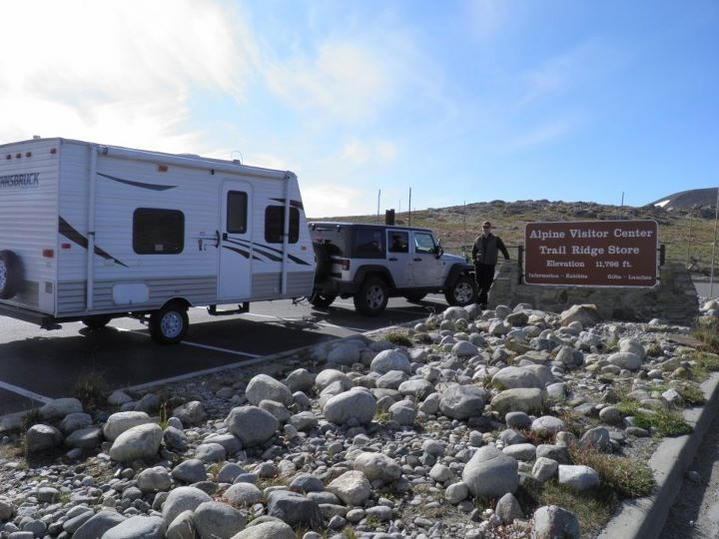

Drove through Rocky Mountain National park last summer with a travel retailer close to 3500 pounds. No problems driving with a manual transmission and stock brakes. Also traveled from Denver and Vail. Trailer had good brakes as well as a good brake controller. Leaving for Yosemete this Saturday from Michigan.

Travel trailer
