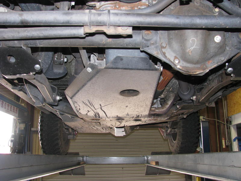

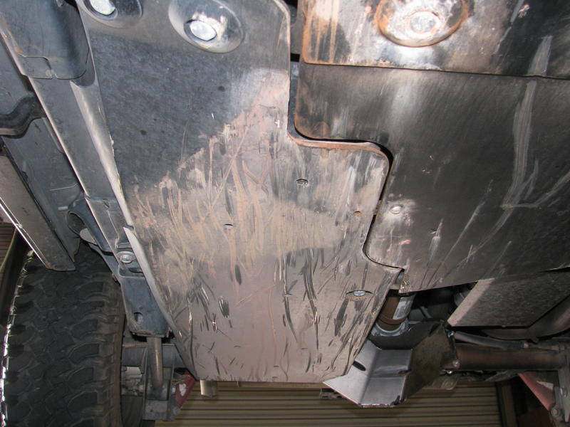

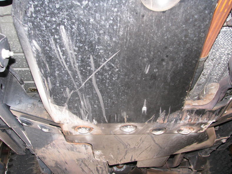

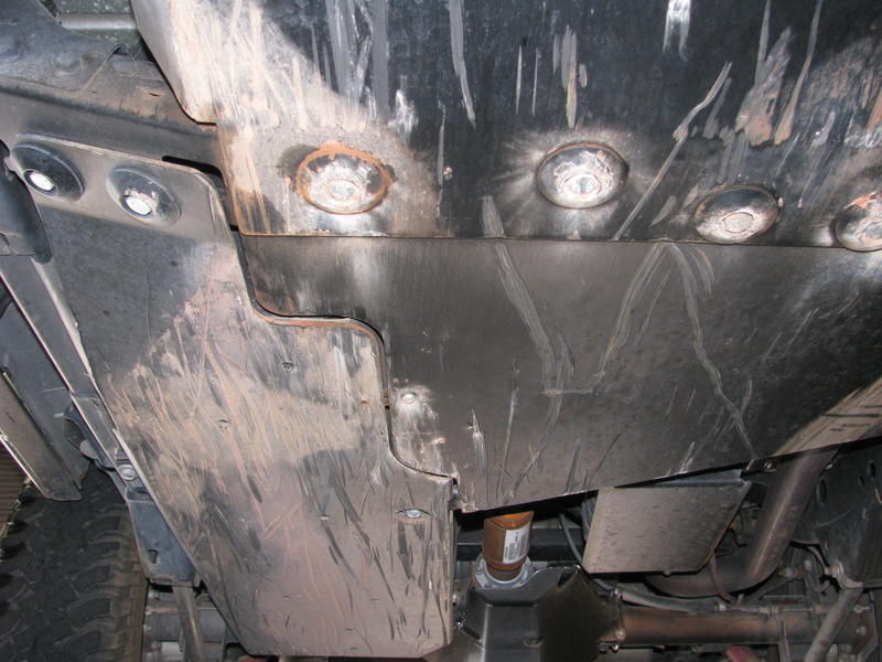

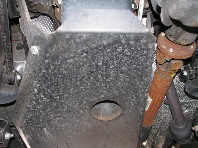

Old Oct 4, 2011 | 10:43 PM
azsandrider's Avatar
Joined: Mar 2009
Posts: 205
From: Mesa, Az
ID:	219392Click image for larger version
ID:	219393Click image for larger version
ID:	219394Click image for larger version
ID:	219395Click image for larger version
I use my skids, but I have a stock height Rubicon on rocky Az trails.
Nothing like having the piece of mind of knowing your completely protected when you hear that rock hit underneath, no worries....Well worth the money.
