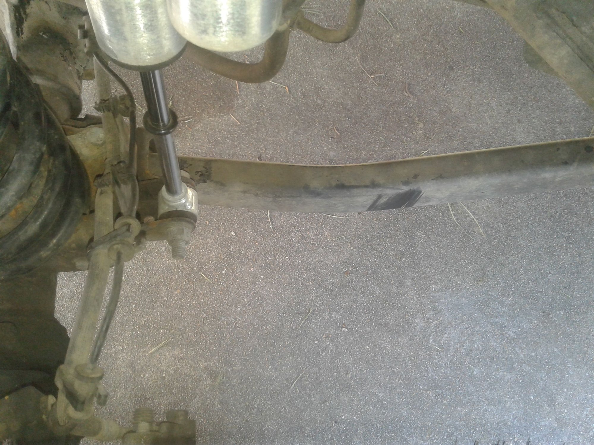

Is this on backwards? Drivers side lower arm

That bend should be going in, not out. It's upside down.

I know its stupid...but this explains a lot. No one has noticed this for over 100k...unreal. i went to adjust the geometry correction brackets and thought, well that doesn't look correct. Thanks resharp for clarifying
