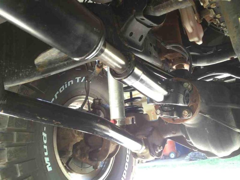

TF is great, CS is great. Their arms are beefy as hell.
Attachment 440666
I could be wrong, wouldn't be first time, but your arms look like they are on backwards. No?
Thought the stock bushing goes on the axle side and flex joint on the frame side. Maybe TF is different.
i was thinking the exact same thing

Depends on the brand arm. The sticker would be upside down or backwards and I believe they come like that.
I don't think they would work flipped do to the angle the arm/joints are at.
Now that I think about it. I would think there would be less bind with the joint at the frame. Obviously at both haha
They are on correct though. I am doing a full mid arm soon. I just learned Synergy uses JJ's and the double adjuster.
