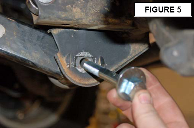

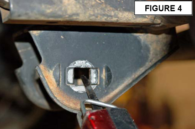

if you had cam bolts, the mounting holes were most likly cut out so the bolts could rotate. These pictures are from the Rough Country install on project-jk.
I didn't do any modification to the control arms brackets when I was installing the cam bolts. Maybe that was why the cam bolts were not working right, but for now, I think I was right that I did no modification to the brackets.
