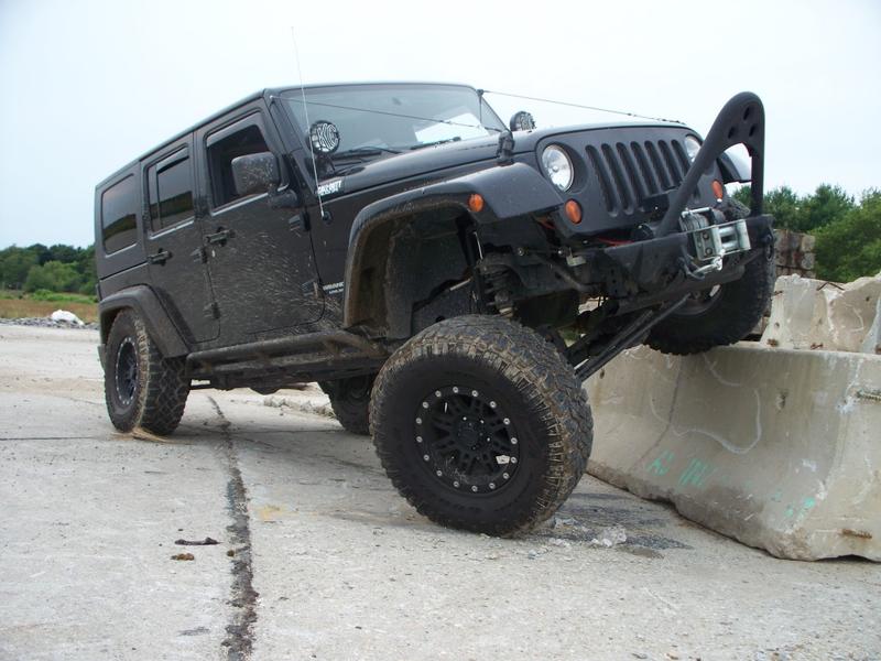

Rear CA's arn't really a priority. I have 5" of lift (TF) and still run stock Rear Upper & Lower, I only replaced the front upper & lower. Everything looks great and the flex limits are fine (+ w/o rear sway bar)... Yeah, I will eventually replace them to push axle further back, but no issues here going on a year.

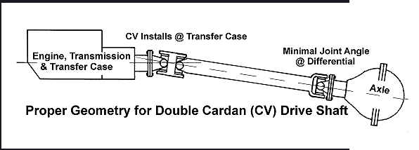

1. The upper rear arms are used to adjust the pinion angle of the rear axle when you add an aftermarket driveshaft:
Name:	Geometry for Drive shaft.png

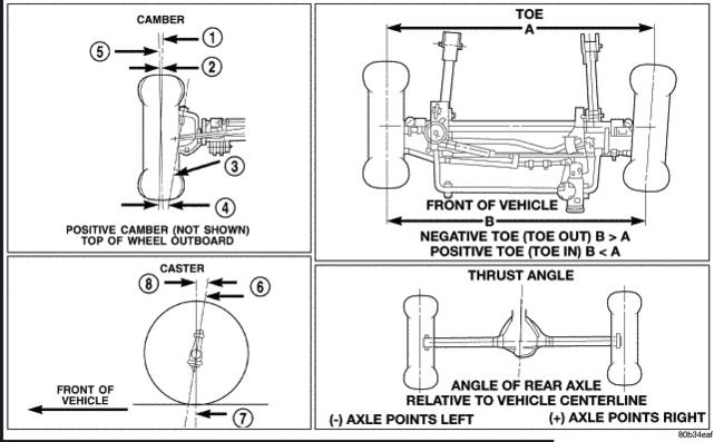

The front lower arms are used to either regain lost wheel base from a lift or to adjust the angle of the front axle for correct caster alignment, or both.
The front upper arms are used to adjust the angle of the front axle for correct caster alignment specs if the front lower arms were used to regain wheel base.
In some circumstances--like with the Currie adjustable front upper arms--front arms can be adjusted much shorter than stock for correct caster alignment specs if the stock arms are still used.
Caster shown in lower left corner:
