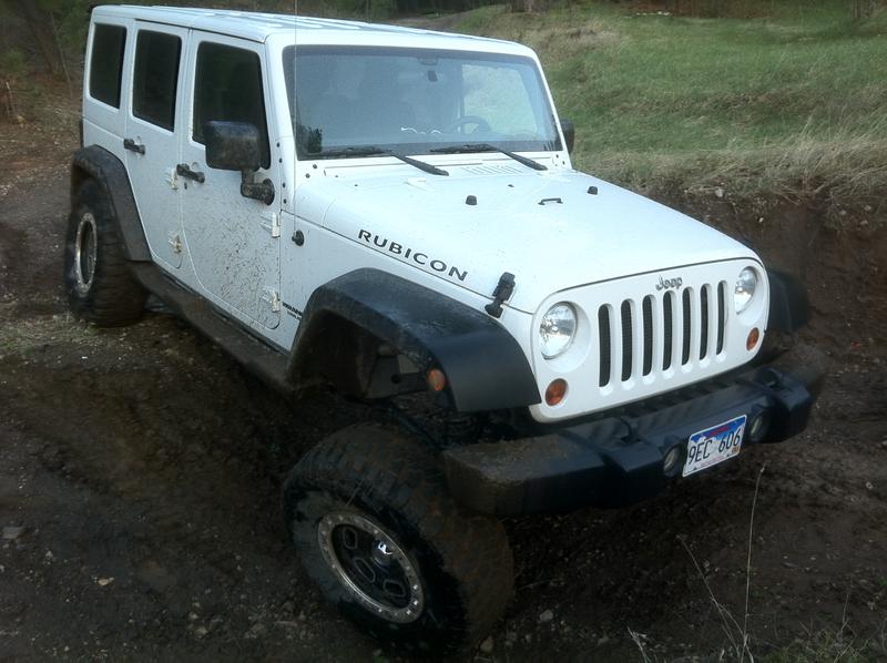

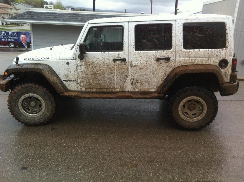

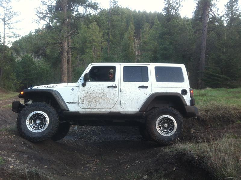

Here is my TF/Mopar 3" lift on 35s. The only time I rub is when I am turning sharp going down hill. Mine came with Fox remote reservoir shocks. I couldn't be happier with the looks and performance of my setup.

Thanks Finisher. This is exactly my dilemma. You have the 3" and you look like you've maintained the factory rake, slightly dipping in the front. Yet I've seen other TF 3" lifts where the rig was leveled from front to back.
It seems like a roll of the dice as to what effect you're going to get with a certain lift.
