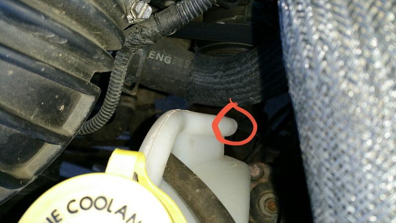

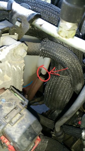

So i went on my first organized trail run last weekend. I had a blast! Unfortunately i have since noticed that i have a small coolant leak. I filled my reservoir tank yesterday and it appeared to be leaking from the circled area. Now the level is at the blue line. Also my heater is not working and i am hearing the "waterfall" sound. I also notice steam pouring out when im at a stop. Tonight i am going to tighten the bleeder screw (could be leaking from there maybe?) and burp the system. Also my radiator is full. The fluid in there is kind of a dark orange (Don't know if thats normal). Any help would be great. If i can't correct it myself this weekend then i will have to suck it up and take it to the dealer on Monday. I have a 2012 JKU Sahara, 35K miles.

Pretty sure that's the overflow drain. Which means coolent isn't circulating properly. The waterfall sounds and steam from the radiator are from antifreeze coming out if that drain. I would check your water pump to see if it's still turning properly. If that's not it you might have something blocked in the radiator
Edit just re read your post check your heater core

The item you circled in your first pic is as noted the coolant recovery tank overflow. It's very likely in your trail run you sloshed coolant out that overflow tube. I'd just top it up (use the right type coolant) and watch it for awhile. If it stabilizes there's no other issue.
