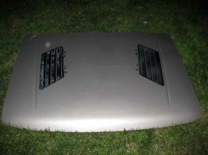

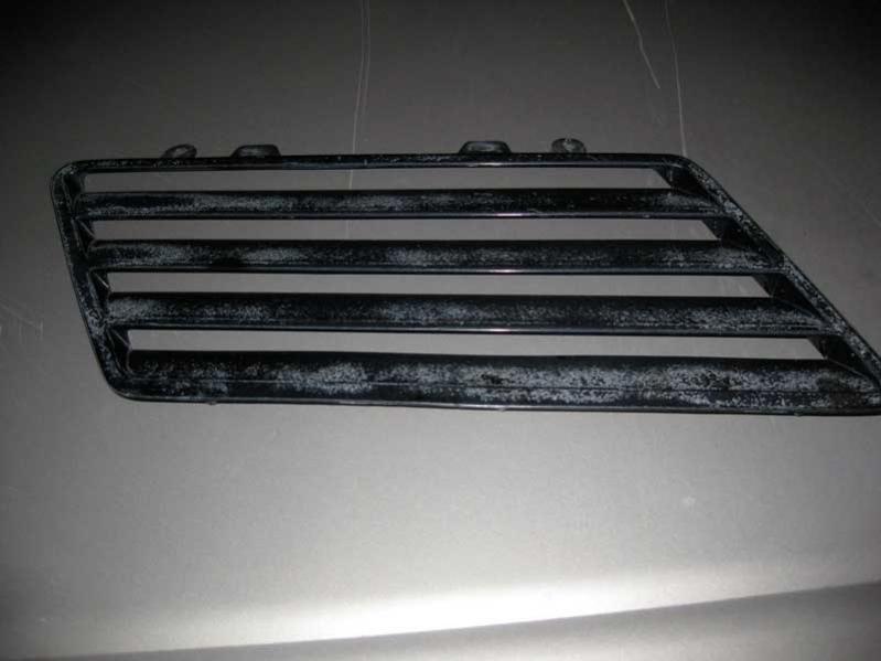

I have a project going now, where I need more cooling on a highly modded pickup. I decided on hood vents for that project. I found some on a mid 90's Z34. I think the car was a lumina.the cool thing, is there were factory trays under the vents that a small hose connected to, to drain away any water that came in thru the vents. The z-34 vents are flat and easily mountable..
If you go this route use a 1/4 cut off wheel (3" size) on an air cutter. Take your time and cut a little, let cool, and repeat. Heat will warp a hood quickly. I found the cut off wheel worked better than a plasma...
These pictures will give you some idea...
