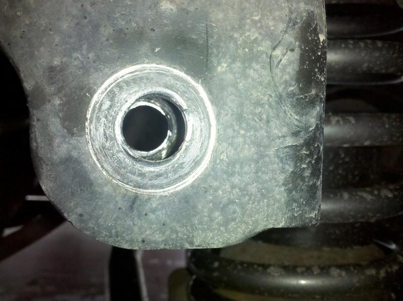

Well I was fortunate enough to meet Pink_Toes on the forum that lives close to where my wife could take our Jeep for him to look at it and see if he could find what was causing our problem. He first centered the steering for my wife and then made sure all the bolts we tightened to specs. He took off the Track bar to inspect the bolt hole to see if it was wallowed out and this is what he found. Click image for larger version

I would say that is likely your problem. An easy cure is to weld some washers, grade 8 I believe over both holes to strength and "re-round" the holes. Easy enough to do if you can weld! Good luck with that! DW sucks seriously.

That's a minor job even if she had to pay some one to do it... Even at 45 dollars an hour... Any welder who can call themselves a welder not a back yard tinkerer could weld that up in 10 minutes... I sure we could net work a fix.... What city is the jk in?

Yep, wallowed out welcome to the club! In our case it went so long and was masked for a long time by out dual steering stablizer...that thing did a lot of damage so get it fixed right away and still check out your other components for damage as well.

Well the Fab shop welded a new piece on the frame and put it all back together and she took it out and had it up to 70 and no DW. I hope this fixed the problem.

I would still definitely go through your other components and make sure they haven't been damaged as well. We started out with the wallowed TB bracket and then slow but surely found out other components met a premature failure all caused by the wallowed TB can't really say which came first but it would give you some piece of mind to know other components are okay.

I thought I read in one of your previous threads that you specifically had the shop pull the trackbar off and check the holes for this? Did they miss it? Or just not bother to check...
