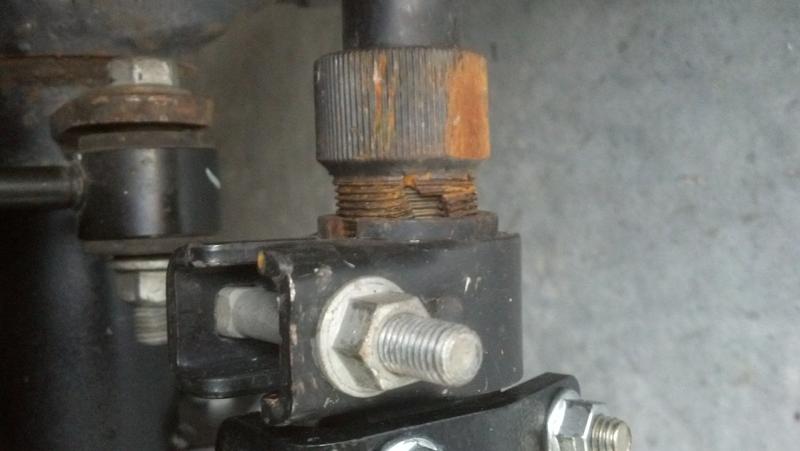

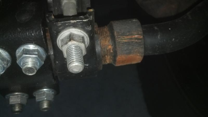

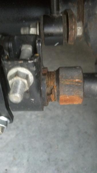

Is this triangle crack normal ...my guess is no, but could use some advice on if this will be ok or needs replacement.Click image for larger version

That is definitively not normal. You should consider a new adjusting sleeve.
Not sure for how much it goes at the dealer but you could get Raybestos 425-1065
http://catalogs.raybestoschassis.com...5&catalog=1000
It goes for $34.24 @ Amazon
And make sure to correctly adjust your toe in

It's hard to tell from the pics but it looks like a manufacturing defect to me. I'd take it back to the dealer and see if it's covered under warranty. Or you could install an upgraded aftermarket tie rod like Synergy or RK.

Thanks for the info...So I guess the question now is better to go with a "HD" tie rod replacement or get the new sleeve and not worry about it?
