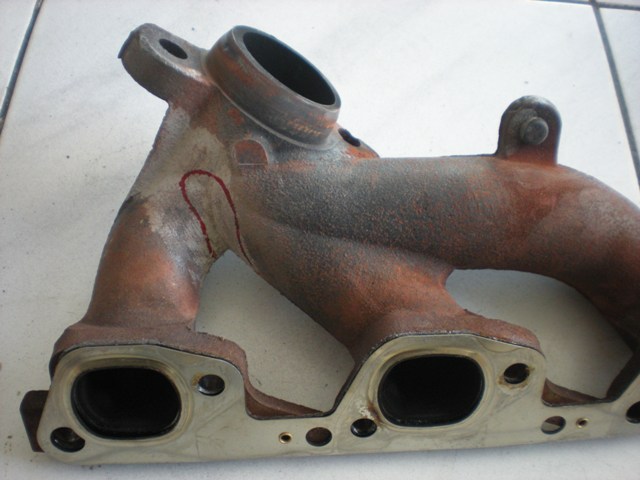

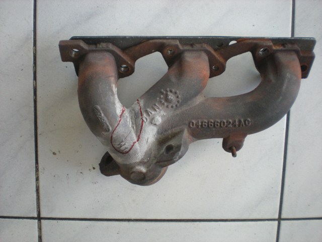

Mine craked in the same area 43000miles.
ID:	23471   Click image for larger version
