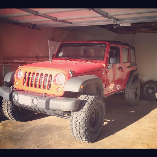

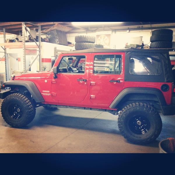

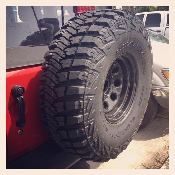

Old Apr 28, 2012 | 08:51 PM
FlameRedJK's Avatar
Posts: 1,367
From: Riverside, Ca
Kinda shows the wheels a lil...Using 1.25" All Pro Offroad wheel spacers
