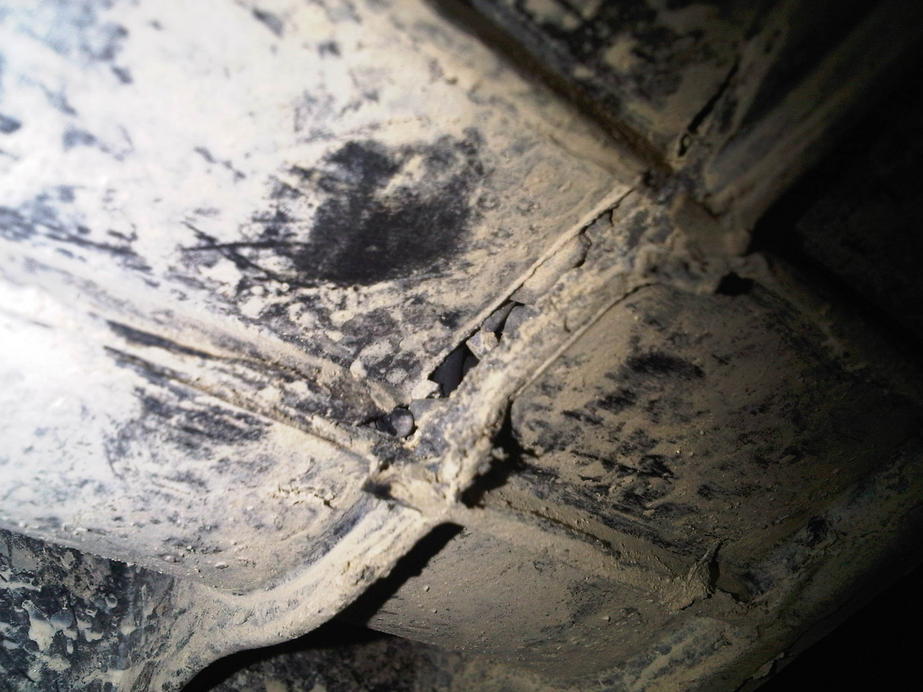

On a recent wheeling trip near Golden, BC, I attempted to cross a bog that was also the tail end of a small rock-slide. Now, I can handle a small rock garden, and I can handle a bog, but when the two were combined, it took it to a whole new level of metal mangling I haven't experienced before.
I now have a very solid idea of where both my driving skill limits, and the limitations of my JK Unlimited X's stock suspension and tires sit. Needless to say, now I have to deal with the fallout, which includes a slightly dented front crossmember, a small crack in the evap canister, and a crunched muffler (see below).

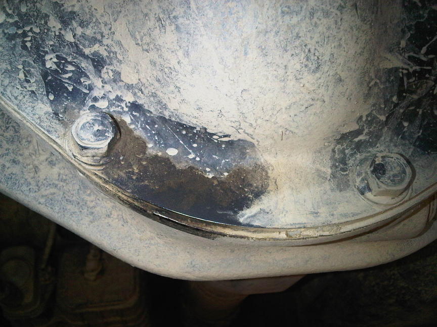

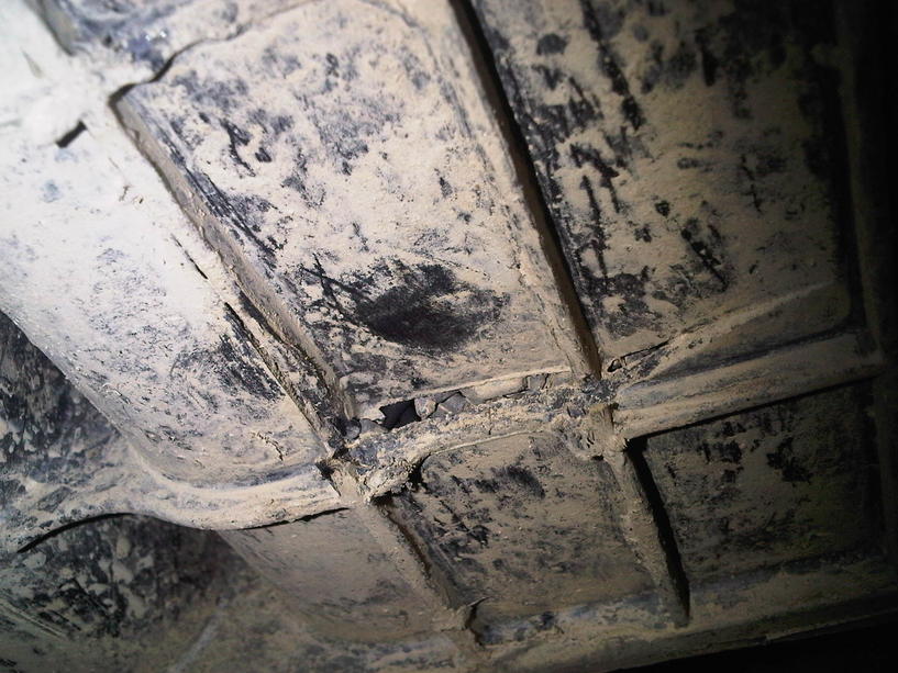

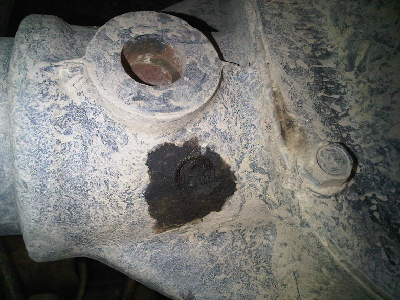

And because everyone loves a little gratuitous carnage, here are some other shots from the underside (although the third one might be an old leak...):
