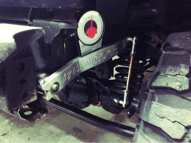

Hey no worries about asking questions thats what the forum is for, just glad I could help out. You probably have your rear sway bar still connected which will help limit the amount of body roll you have, thats why you didn't notice a difference. I am running anti-rock front and rear so I notice quite a bit more body roll. I would suggest taking your rear sway bar off and then driving around town to get a feel for it and then you could make adjustments if you like. Honestly looking at the angle of yours thats probably ideal for you, if you run neutral or negative angle you run the risk of the sway bar swinging around and impacting your front bumper if your flexing your suspension drastically.
Ok. Just played with the Jeep more today, and im feeling a difference with antirocks. I think they work. But so far i could only put hands in the city/highway driving. Can't wait to test it offroad. May do it this Sunday. I think im getting used to the angle i have, i was just a little frustrated yesterday after having a hard time figuiring out how to install it.

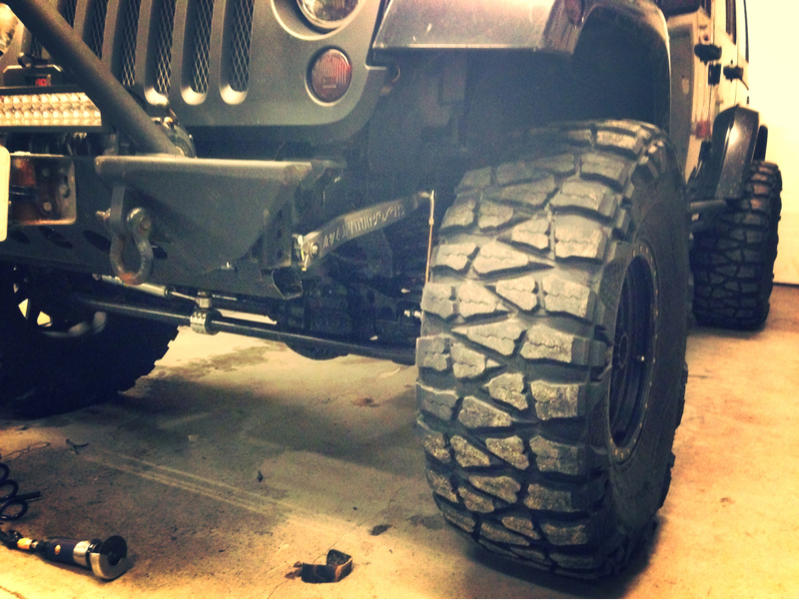

To the OP. It looks fine, but take a look at trimming the body mount. It looks like you will contact it at full compression. I had to do this with mine. I have Antirocks front and rear, and love them. The jeep is very predictable on the trails.

I installed the front Antirock on my JK a few days ago, I set to 15 degrees and it was about right for my down travel (4-6" Bilsteins).
Ended up going with the pretty Antirocks
