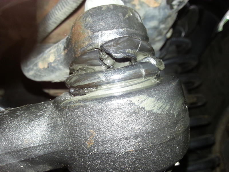

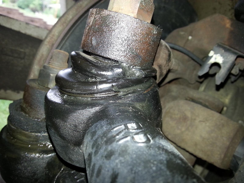

Here's an update and another reason not to go with Currie. This is round two on the boots. I'm calling and complaining but not expecting much result from Currie.
Drag link boot at pitman arm

Drag link boot at wheel
