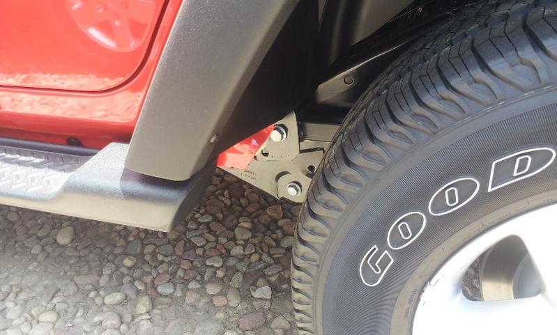

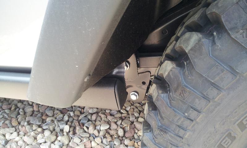

Sure enough. That last one is a 2013 but no trimmed pinch.

Yeah mine is a 13 and no trimmed pinch seam. I was just surprised the dealership did it for me. And a couple of parts I ordered were cheaper than a few catalogs I have here (not to mention names). Not my typical stealership experience, something must be wrong!!
