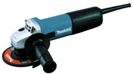

Will the side of that blade also work as a grinder? In other words, can I turn on and lock the chop saw in the down position, while slowly pushing the bracket towards the blade? Or would it cause too much friction or pressure to possibly damage the blade or saw?
Just curious at this point, just in case I undercut and need to shave off 1/32". Otherwise, I guess I could just put the bracket in a vise and use my handheld grinder.

you shouldn't use it as a grinder. Just use the angle grinder in the vise to clean it up. It will cut real straight and clean probably, so you shouldn't have too much more to do than just clean the edges a tiny bit.
